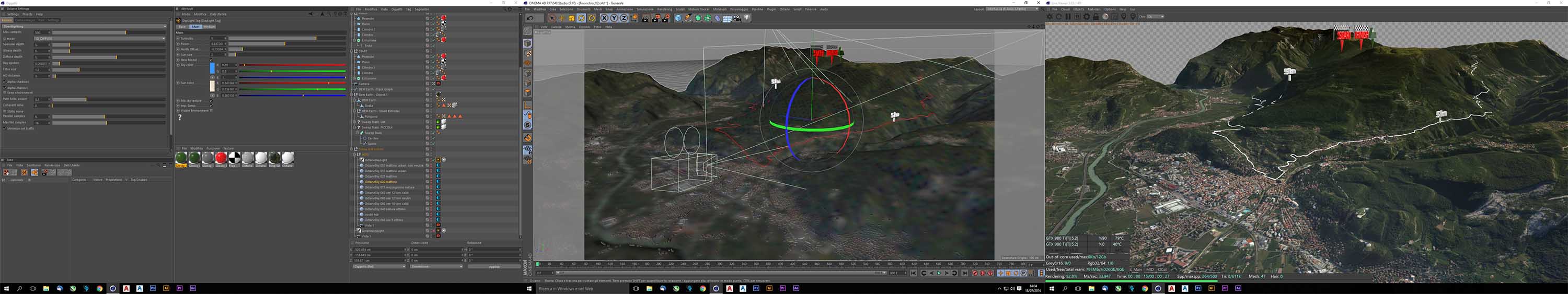

Hi, I am using C4D in a 3 monitor configuration. The main monitor is the central one, while on the other i set 2 windows with the tools i need. When i click on something on the left or right screen, for example for select an object on the list (left screen), or to render the scene (right screen), the 3d connexion software detects as i am changing profile (C4d to Windows Explorer, and then again in C4d) and this cause a delay on the response of the mouse: it doesn't work for at least 6-7 seconds, then it detects the c4d profile and it works properly.
It happen every time i click on different monitor, and it's very uncomfortable. If i use a Single viewport on a single monitor the mouse works good, but i bought 3 monitors for this :D
how can i solve the problem? is there a method to "lock" the c4d profile?
see the attachment to understand my configuration

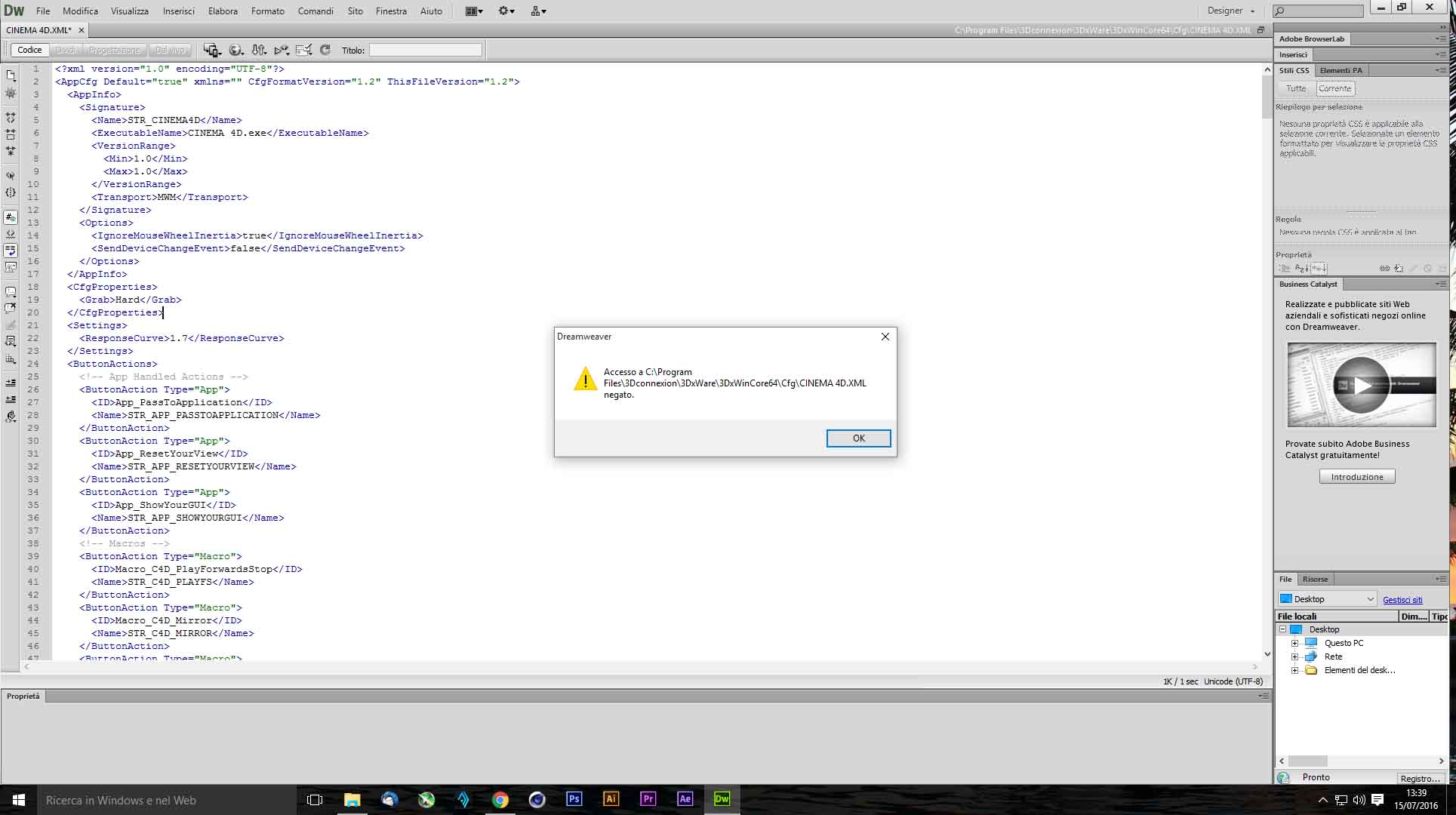

I found it... but when i try to save the file with the new strings, it tells me "access denied"... even with dreamweaver or block notes...
i tried even to stop the 3dxconnection process by the task manager, but same error :(

You need admin privileges to write into that directory. And just use notepad so the editor doesn't add any formatting.
If you don't have admin privileges, tell me, and I'll see if you can add it to your file in %APPDATA% which you do have access to.

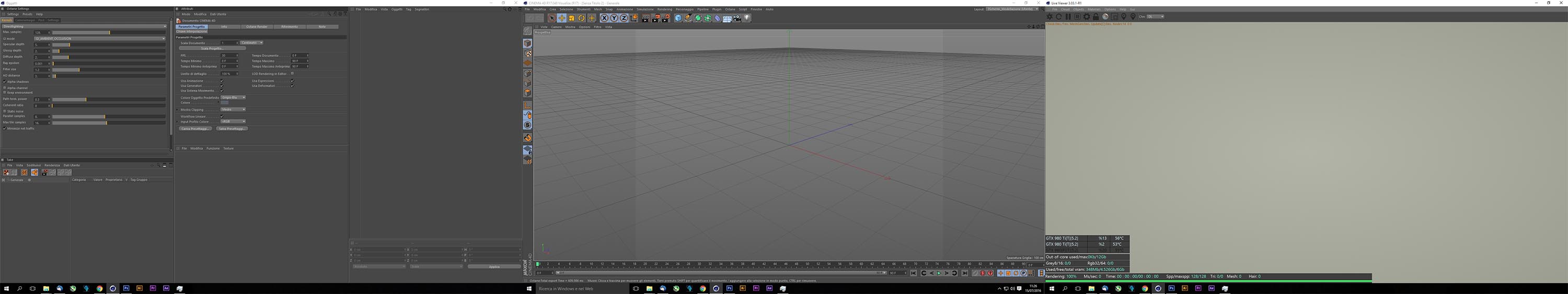

I've reinstalled the lastest version of the 3dware, nothing has changed.. as you can see on the attachment, on my central screen i have the work viewport, on the left screen i have the "item list", the properties of the selected item, materials list, take list and the Octane render settings. On the other side, right screen i have the Octane Live viewer. But it doesn't matter what i have in the windows, IF i have another window the driver of the spacemouse delays.
As you can see in the top of the windows, the one in the center screen is "active" (the text CINEMA 4D R17...... is black), while the other are gray, so inactive (Oggetti (object) on the left, and Live Viewer on the right). When i click one of those windows the driver delays as you can see in my previous video.
